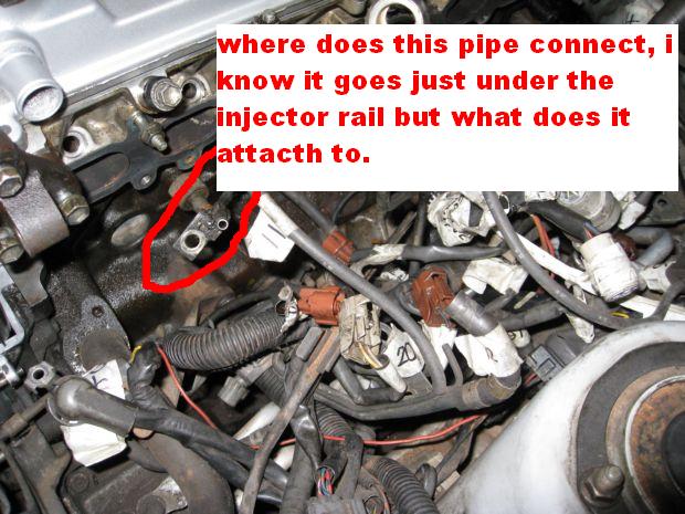

check these pics out see if you can tell me or show me with pictures what this attacheds to.

It depends, is that a water, fuel, or vacuum line. Also, where does it run to?

Difficult to say from your photos Andy, but that pipe looks like the one I've marked in the photos below, the hose sticking up at the top connects to the small metal vacuum pipe in front of the 3000 intake pipe. Supramacist was right I had the engine out last year to do a big end-repair and was able to take lots of pic`s,

looks like the coolant line that runs to the throttle body/isc. does the other end go to a metal pipe that goes behind to motor?
