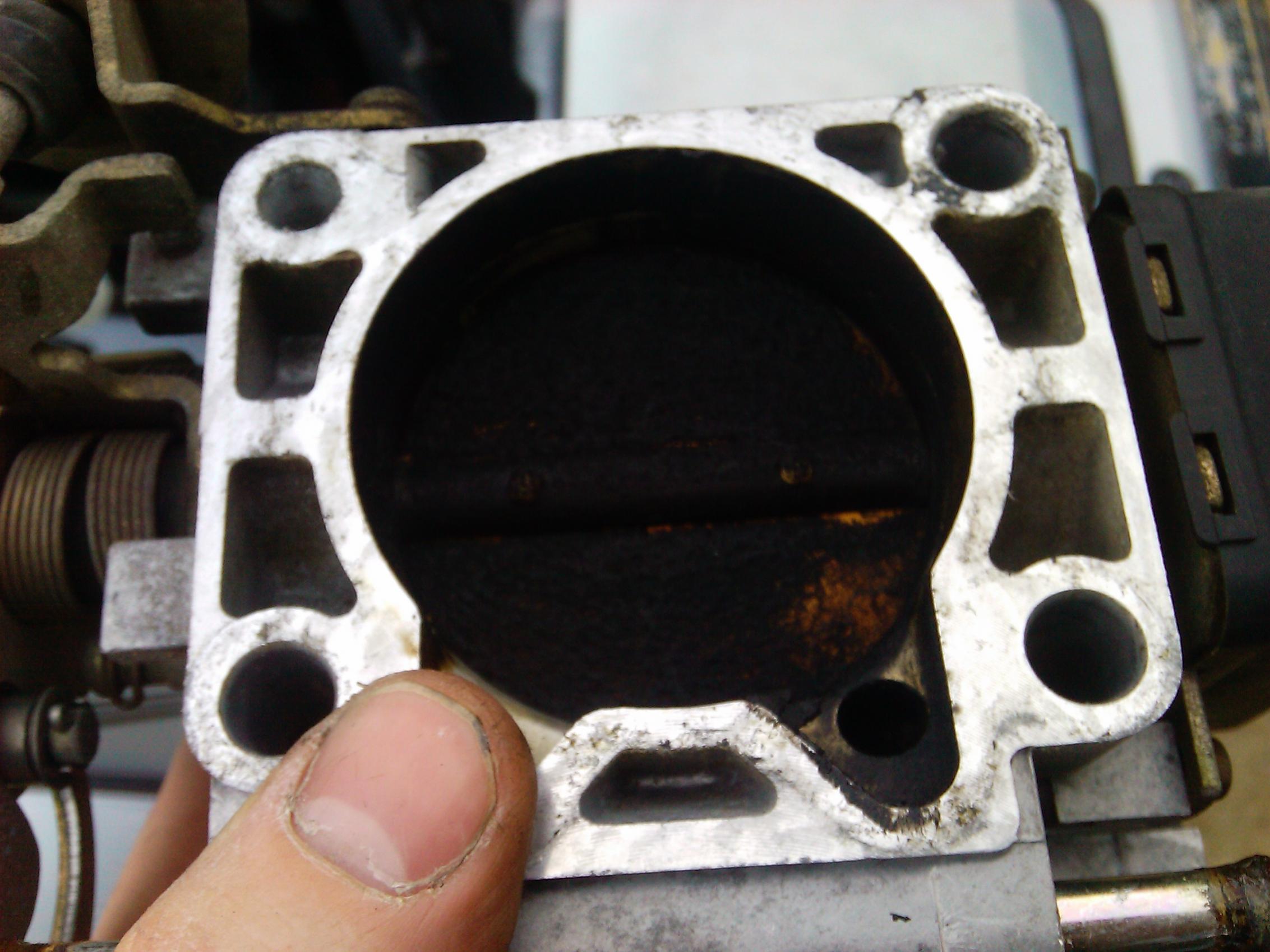

mechrider89 06-07-2012 04:08 AM
1 Attachment(s)
ya mine idles low as well but I think I found my problem:
Attachment 4592
My whole intake system looked like that!
plus my ignition system is in desperate need of maintenance, so that's another place to check out for your problem.
