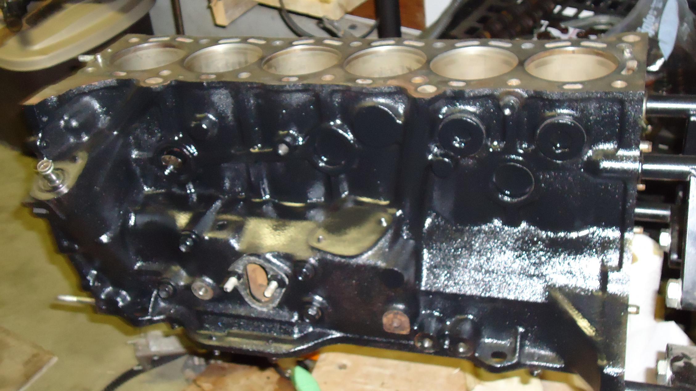

CanadianBak'inSupra 12-14-2011 01:37 PM
3 Attachment(s)
got the block painted up nice.
ordered gaskets for the whole engine, online i priced a toyota set for 300$ with shipping, lordco offered me 180$ for a decent brand.
Attachment 4419
Attachment 4420
Attachment 4421

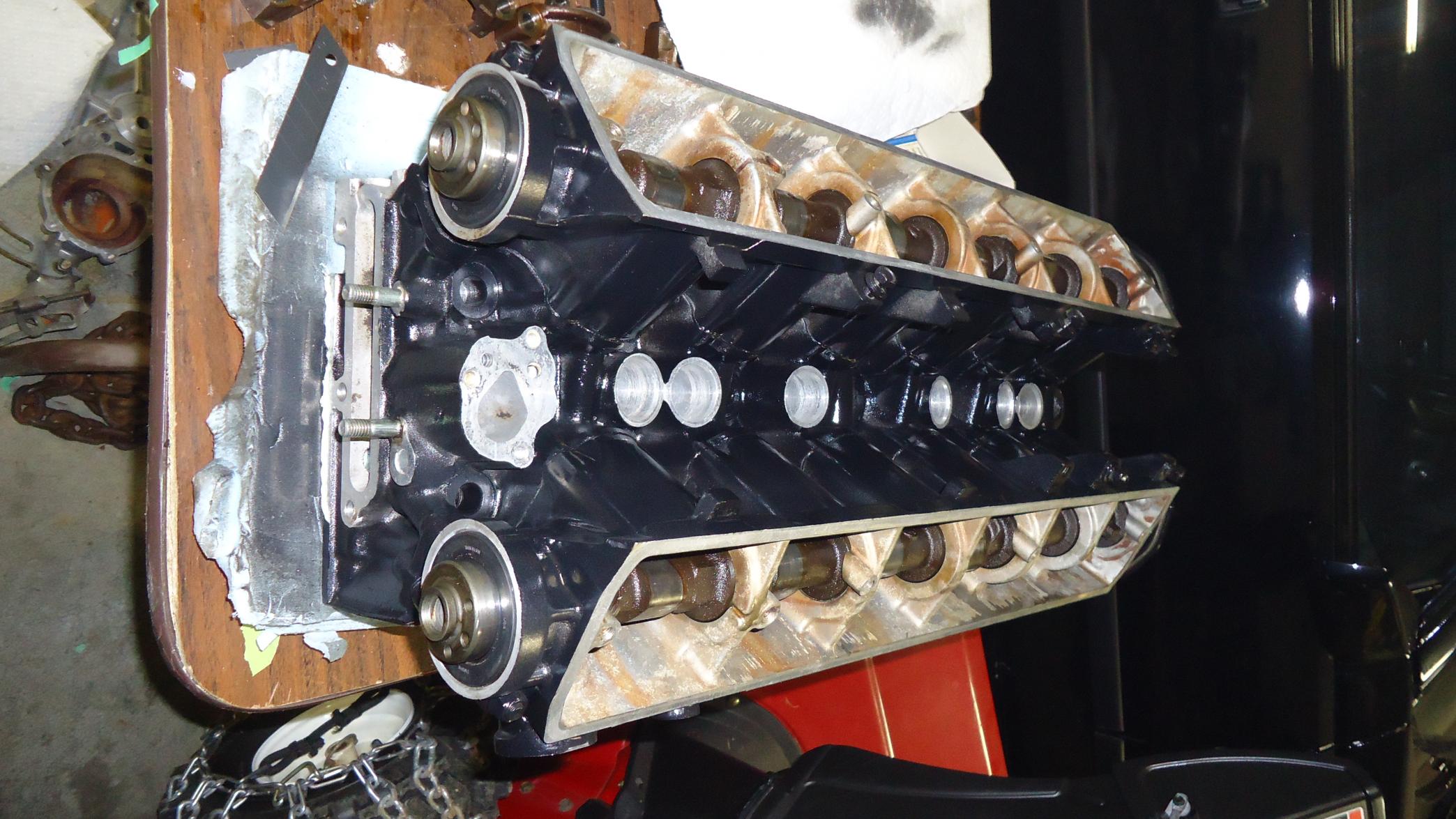

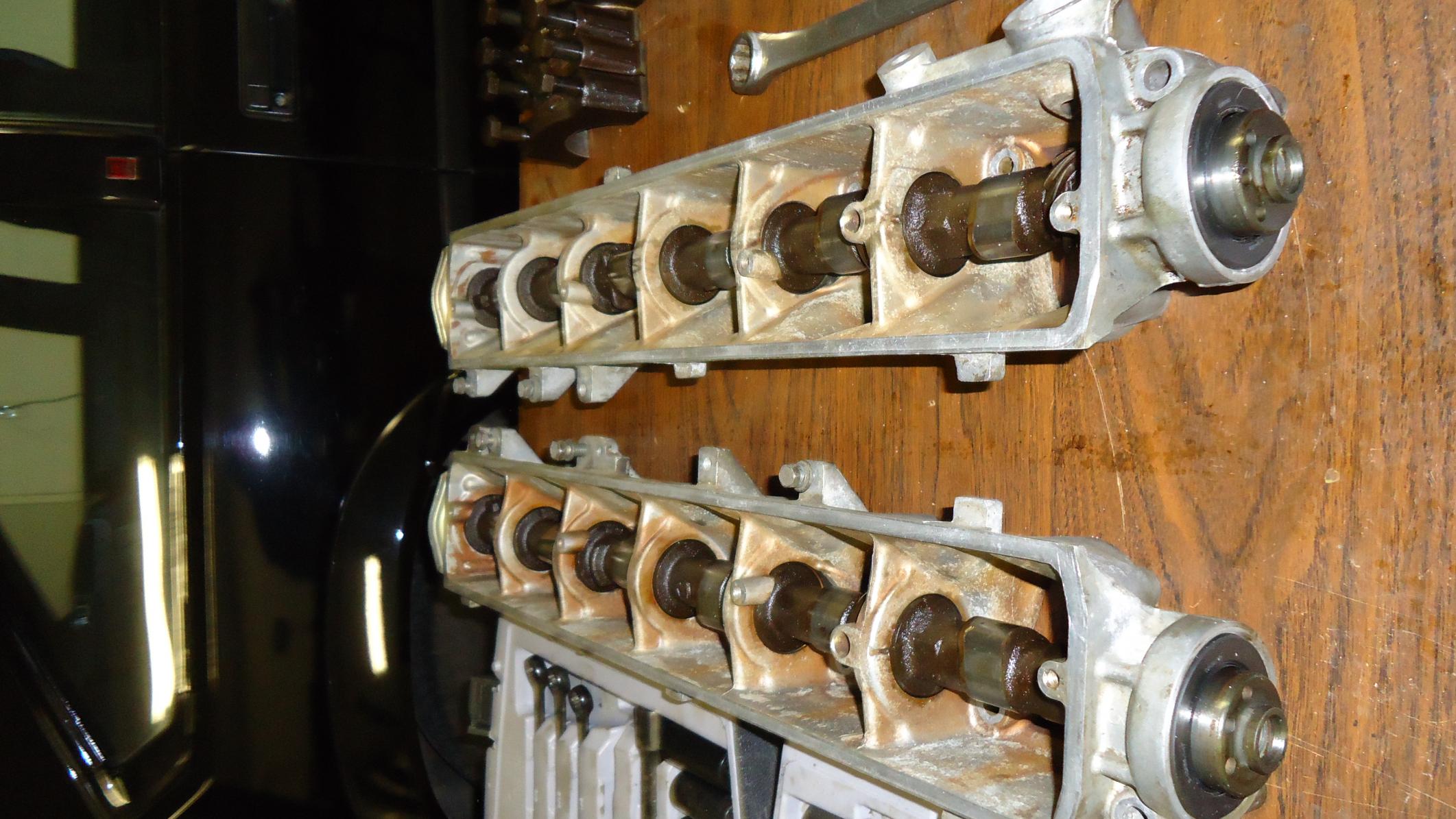

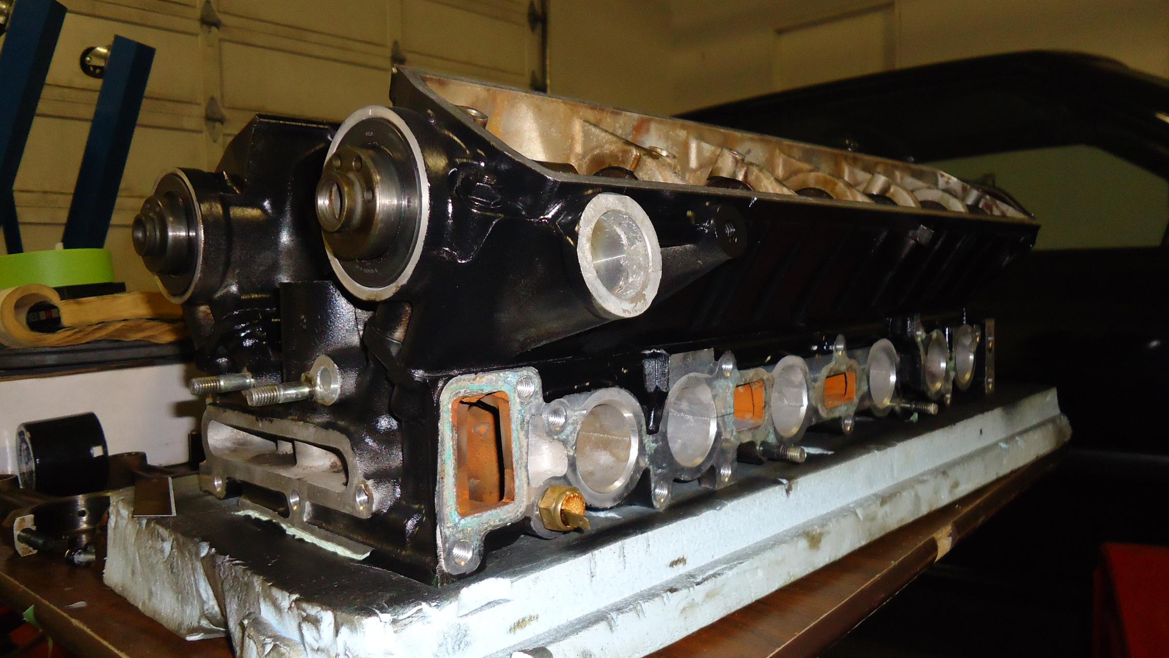

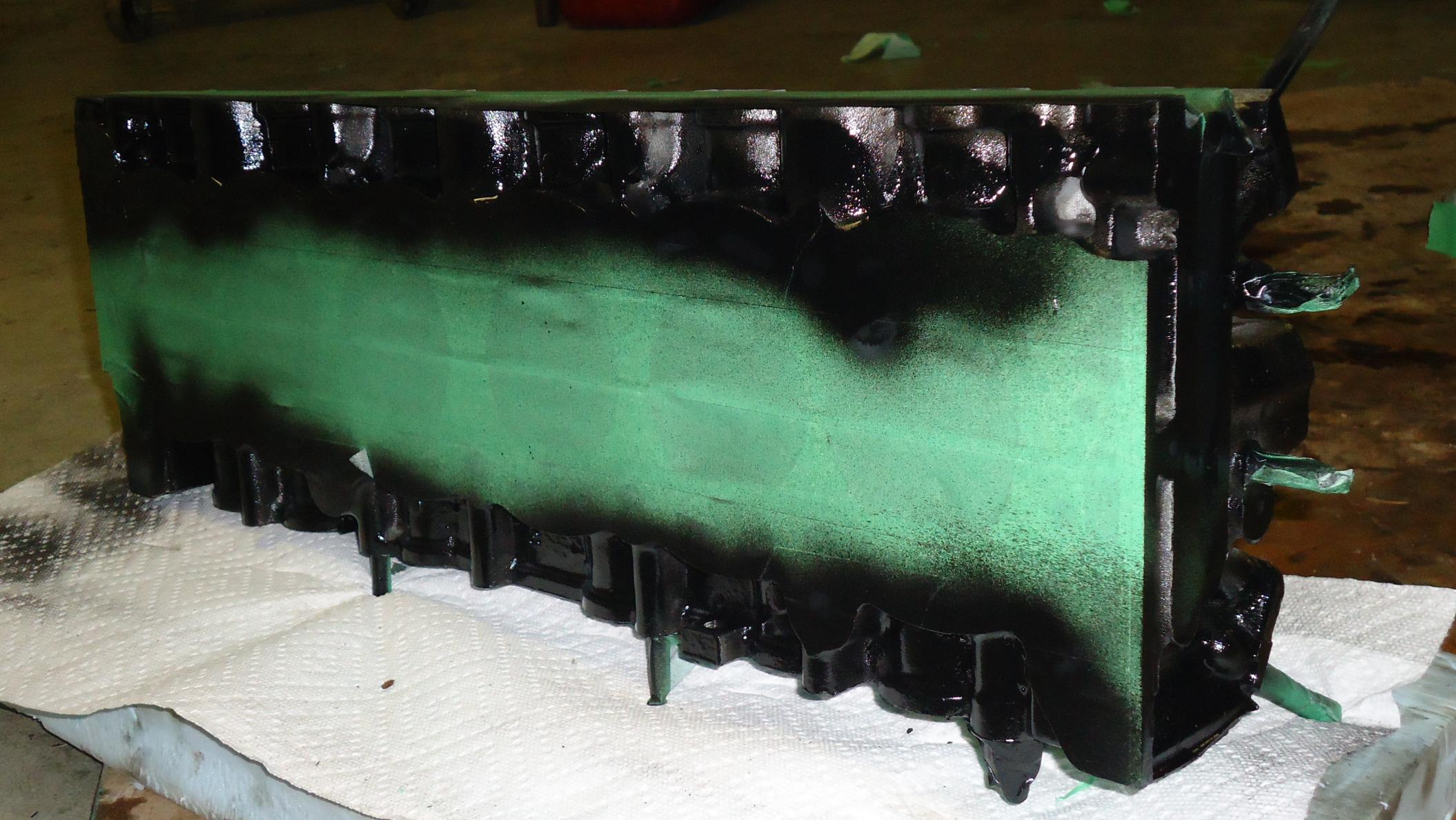

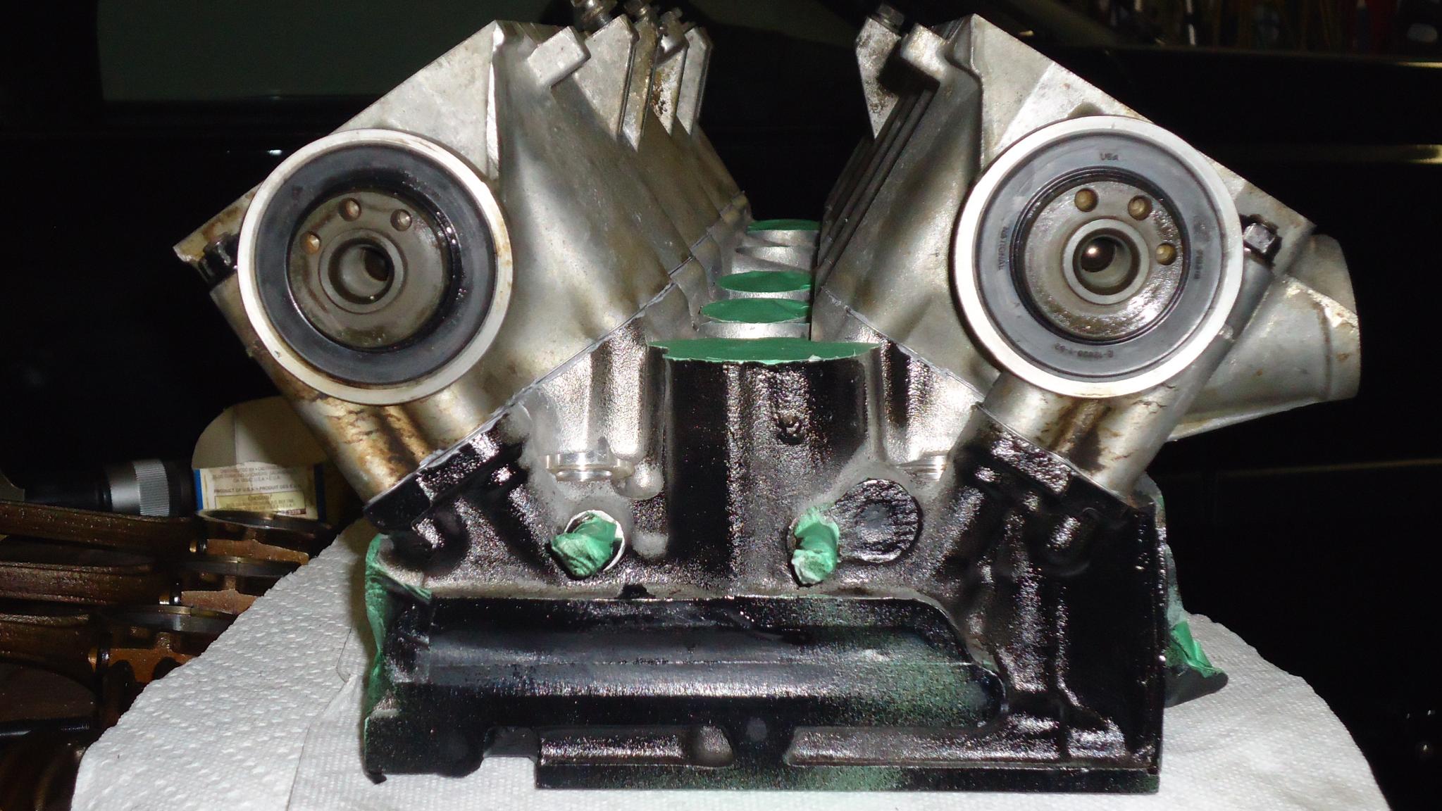

CanadianBak'inSupra 12-23-2011 02:48 PM
5 Attachment(s)
some pictures
Attachment 4438
Attachment 4439
Attachment 4440
Attachment 4441
Attachment 4442
ive got more work done since but im saving the pics for further progress :D:grinking:
