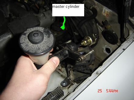

for the brake pedal there is a 14mm nut and bolt. i found it was easier to take the black box off that is right above the steering coloum (a 10 or 12mm bolt dont forget how this goes on.) once that is off you be able to use a rachet, extender, and 14mm socket. fit that on one bolt and then use a 14mm wrench. it might be a bit of a nuckle buster.
for the clucth pedal you need the bracket as well. if you look under the hood in the driver side corner you will see 3 holes 2 small ones for bolts and one larger one. when you have all the clucth lines set up you will be able to put in the master cylinder. you put it in place and then go under the dash and put up the clucth pedal bracket and put on the nuts and bolts and your done.
