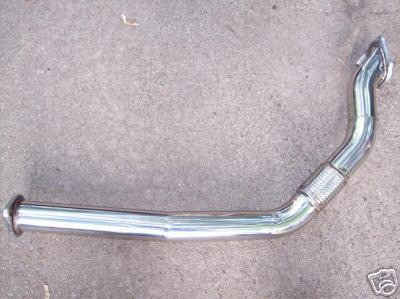

joel w 12-04-2005 09:30 PM
yes, BIC and Titan downpipes both dont use the 90 ell im sure there are others that no longer need the 90 ell aswell....

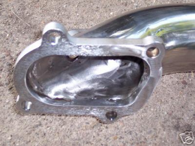

here is mine. its from titan motorsports..
http://www.toyota-supra.info/forums/...ttachmentid=52
http://www.toyota-supra.info/forums/...ttachmentid=53
