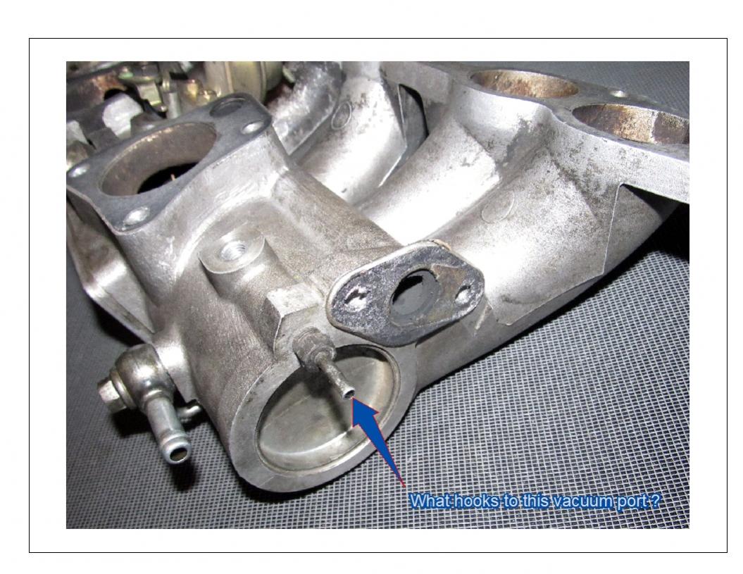

Question. What plugs into the Vacuum Port in the rear of the Intake Manifold by the EGR tube connection on a 1990 Supra N/A? I don't see anything unplugged.

Here's a pic. Attachment 5022

OK, easy. That hose comes out and connects to a plastic T on the firewall. One side the T connects to a hard plastic hose that goes over to the heater control valve. I think there's a vacuum check valve there too. The other side connects to the cruise control and further on connects to the vacuum / pressure transducer that displays vacuum / pressure on the dashboard. There is another double T in that line between the cruise control and the transducer. See the photos and arrows. This is on a 1987 Turbo car. There may have been some changes between non-turbo and later years.

Thanx, that's what I needed.
