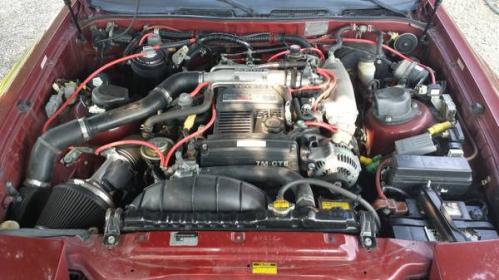

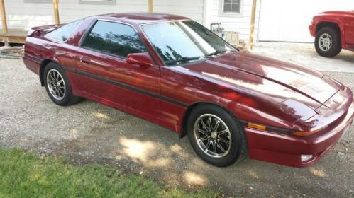

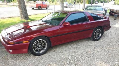

*Pictures*
4 Attachment(s)
Here are the pictures the current owner sent me.
Attachment 4874
Attachment 4875
Attachment 4876
Attachment 4877

What other information do you want? Have a compression test done, check oil and coolant for signs of contamination, check for diagnostics codes AFTER test driving it for a little bit (some people clear them before a buyer arrives but driving around until it warms up will cause most critical codes to show back up)... See the MKIII FAQ section for info on checking diagnostic codes, it's easy and you only need a paperclip.
