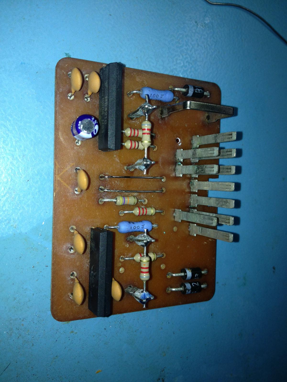

Hi! -- I've been away from my car for a while but now I have carried out a deep investigation and found that the problem was --a lamp failure unit
partially full of water , this was shorting out the lamp curcuit when braking , deeper investigation found that the lip under the rubber weather trim had rusted away in several places allowing water to enter the interior ,AND ,after opening the unit I found the curcuit board had corroded away --see picture above . I will now repair the lip and search for another unit , this one has been eaten away too! . The next unit I get , I will drill some drainage holes in the cover and then reassemble , purely as a secondary precaution.

I have found a curcuit board repairer and I have had my board ( lamp fail unit part number 89373-14020 ) repaired by :

I am very pleased with the results and I now have the unit refitted and working again . Below are the pictures of the board in after and before state .

I recommend this Company if you have any curcuit board problems .
