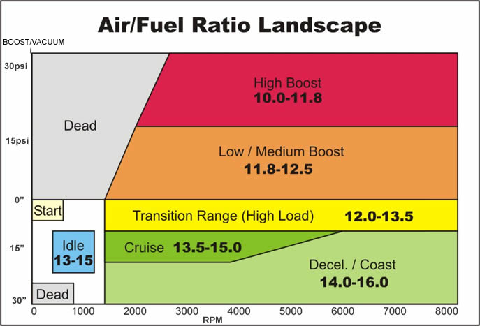

cre 06-28-2012 06:21 AM
1 Attachment(s)
This may be of use to some. It's not an absolute but it is accurate for most basic setups.
Attachment 4620
