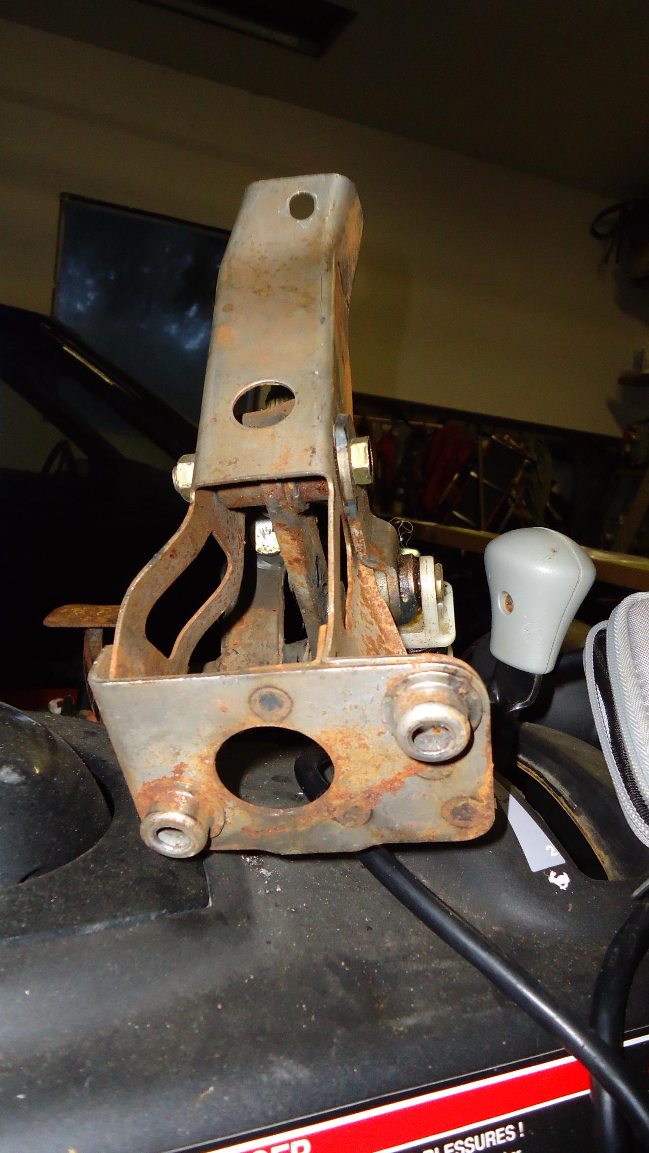

this is an assembly from an 87 i hope this helps:
Attachment 4461
^there should be 1 small bolt and 2 nuts from the master and then a clevis pin and clip connecting the pedal to the piston. they should all be possible with extension combos, or possibly stuby wrenches. its been awhile but i remember it being a big pain in the mark3...

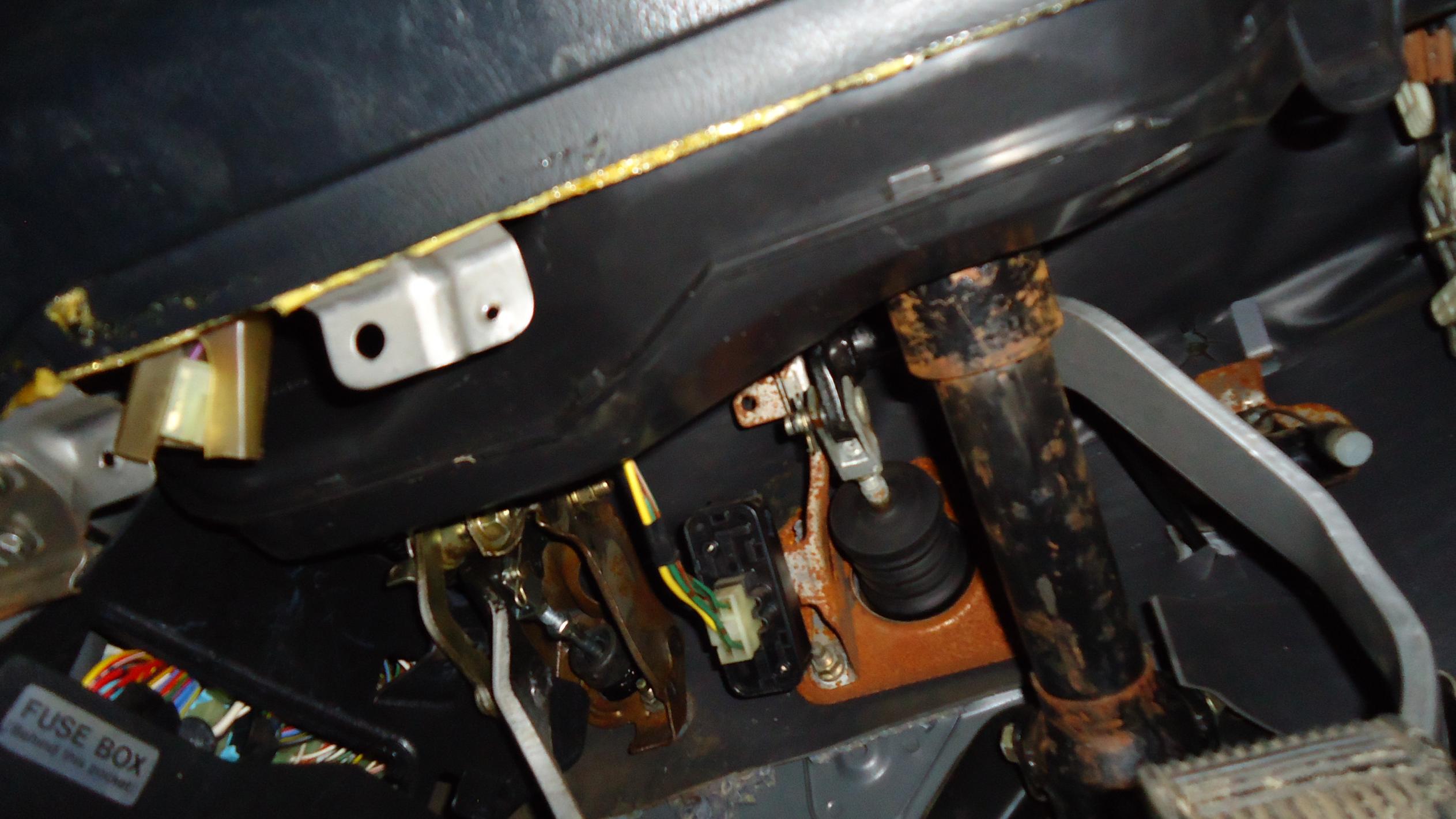

the below pictures are in my 84 (mark2) it used to be an automatic trans. the assembly are almost the same so it give ya an idea what it looks like down there...
Attachment 4462
Attachment 4463
only one nut is visible, the bolt at the very top and the other nut is time consuming...

Thanks very much for the hints and the pictures! I realize that the 2nd nut from the master is not visible and that you must get it by "feel". I don't look forward to that. For future reference, your 1st photo shows the pedal bracket off the car. So.....the single bolt to the bottom of the dash and the two studs from the clutch master are the only attachment points that affix the bracket to the car???
CanadianBak'inSupra 01-29-2012 06:22 PM
yes just that bolt holds it, and the fact that it sandwiches the firewall between itself and the master cylinder, with the two studs on the master.
