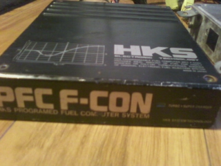

Like the tittle says, i landed a HKS fcon plug and play, with a newish 7mgte m/t ecu and and K type FCD already wired. the guys we got our truck load of 7m's and parts from seemed shady, okay really shady. but on that note they had some nice cars. anywase part of the bargen was this fcon system and these yellow top feed injectors. check em out

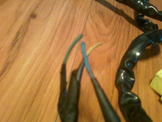

As far as the fcon, as you can see there are three wires that are cut and come out of the ecu, Blue, Green, yellow. Looked up the pdf of the old style fcon because i doubt this is a vpro or whatever, and its for the hks 1 to 3 bar map, found it on ebay for 25 bucks shipped. not a big deal..
how ever there are two screws that hold on the inspection cover, obviously someones been in here. there is a main chip and the label is missing.. uh oh..

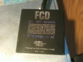

the FCD looks fine, though i read the "k type" is more preferred for the 7mgte system. however it doesn't have the adjustment screw.. weird..
Does anybody know what the hell im looking at?? is this all junk or gold??

Should have posted this in the MKIII section. The only stock yellow topped MKIII injectors are from the earlier models of the GE... not something you'll want anywhere near a GTE (not even a stock GTE). Have you looked up the part number? It should be embossed in the side.
Without knowing what chip is in the F-CON I wouldn't run it until I managed to procure one I know will work with my build.
