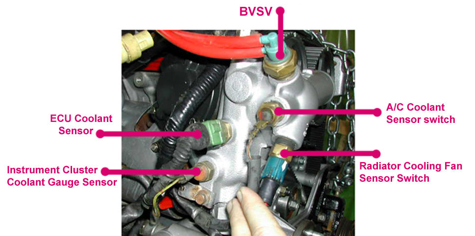

What are the names of the three water temp. Sensors that are right before the thermostat. I want to replace them but the auto store has no idea what I'm talking about. Then they try to sell me a sensor that doesn't go on my car.
cre 03-03-2011 04:23 AM
1 Attachment(s)
You're probably only going to be able to get from a dealership or a Toyota parts dealer. Have you tested them? No need to blindly replace them.
Attachment 3765

I have not tested them. I have a n/a I don't have the fan switch or the a/c sensor I have the other two and one more that goes in the top of the housing by the bvsv
