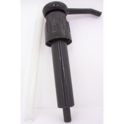

Busted Knuckles 06-25-2010 11:00 PM
In the car. The fill plug is on the driver's side, middle of transmission, half way up. Can't miss it. I have a hand pump to pump gear lube from the container into the transmission. Just pump until the fluid trickles out, and your done.
http://contentinfo.autozone.com/znet...89996/image/4/
