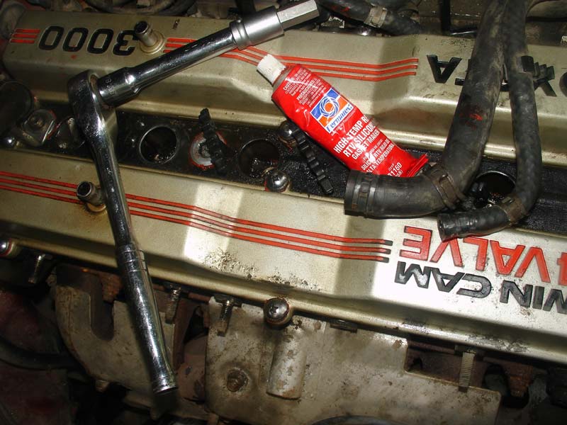

The oil plugs are the four plugs on the top of the engine that also hold that spark plug cover down. If you look they are probably leaking. On mine I took them out and did away with the cover and sealed each with rtv sealant. Its been working quite well.

Thanks for that info. I was about to put the plenum on. Anyone know what size that huge allan head is on those oil plugs? What do you use? A Big allan wrench?... and where do you find one that big? Thanks
907mge 05-26-2010 12:56 AM
Well since I happen to have a cyl. head laying down stairs I checked for you. What I used is a 14mm allen socket for 1/2 drive. You should be able to get one at your auto zone.

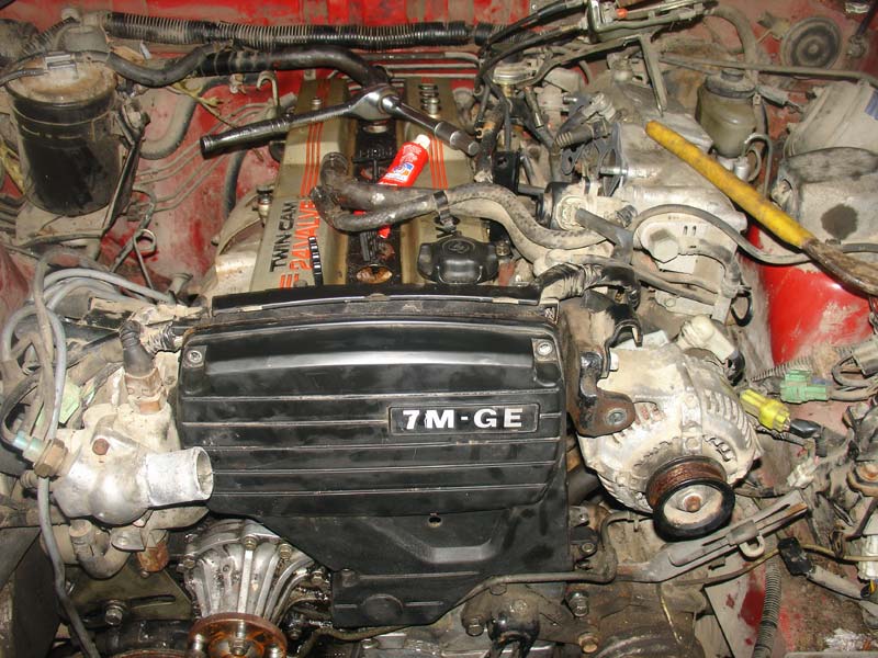

Yeah I tried the double nut but it just walked up the bolt so I bought the tool. Taking care I removed the plugs cleaned them and the hole with de-greaser coated with High Temp red RTV and then very carefully put them back in. That plate makes it easy to cross thread these so I was cautious. Mine were not very tight either must be because those caps would be so easy to over tighten. Here are a couple of pics.
