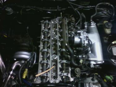

Putting the new ported head on, everythings going like a toyota build.. so a pain in the ass.. the only thing left to do is put oil in it, buy spark plugs and tourge the studs. but i have YET to find the tourqe specs on ARP head studs. so here goes yet another night of not hearing my car run. Does anybody know the specs and if you gotta crank em then back it off then crank again?:dunno:
Oh and i put number 1 pistion at TDC and put the cams a TDC put the belt on and cranked it 4 times to make sure it was still stright perfect and it is but then i thought.. is everything sapossed to be right at tdc? Loll.

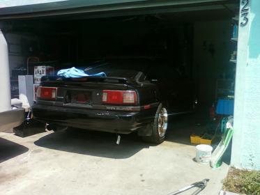

heres how the build is going and a rear shot of the new rims :D( the car is just really dirty)`

so check this out, i lined the cams notches up with the #2 timing cover notches and shined a light at the crand and the notch on the crank pully was JUUUUUSSSSt to the left/obove 0. as i gently bumped the crank dead on 0 the cams look just and im mean litlery just next the the notch's on the metal #2 T cover..
BUT it looks too close to pop the T belt off and move over a tooth, might throw the whole thing off.. i can provid a pic of how close man, so by your judgment to pop it off and move it over. but it looks great but i dont know how forgiving toyota is, this would have passed with flying colors on any of my hondas..

I'm not 100% sure I understand the question... I'd probably need pics to make a call on it. If you're judging the cranks position on the damper's markings that may be the issue right there... the rubber in the damper dries out and warps over time allowing the outer sleeve to slip putting the marking out of alignment. If its ony one or two millimeters off I wouldn't sweat it as long as the crank was really at 0 when you zeroed out the cam gears. If you judged by the damper, just pull the #1 spark plug and rotate the crank manually until the chopstick stops moving upward... now you're at TDC. ;)
A couple degrees won't keep it from running and timing's easy to redo if things don't feel right.... If I'm misunderstanding what you're dilemma is then please post some pictures.

yea, i was going off the timing 0, 5, 10, 15 marks on the lastic cover at the bottom and the notch on the crank, but i put it in time the first time by a long part of a plastic coat hanger in #1 and when it stalled at the peak i put those cams in TDC and roated it to make sure and it was perfect.
