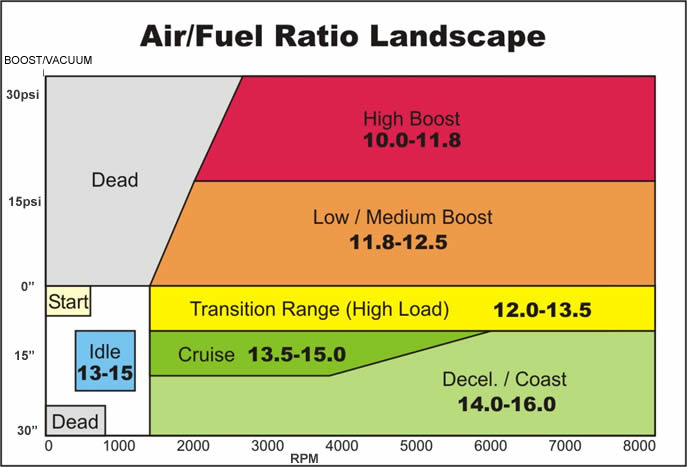

1 Attachment(s)
I will get back to you on this soon, I promise... Just been VERY busy.
Let's start with this though:
Attachment 2829
You cannot adjust the AFR for upper-mid loads or throttle less than about 70% (or 2.70v at the TPS). In order to do so you would need to force the ECU into open loop operation full time and I don't recommend it except under special circumstances... the potential benefits are too small to justify the potential headaches.

Well, don't do anything to force the ECU into open loop operation full time (like removing or disconnecting the stock O2 sensor) and keep the low range zeroed out and the ECU will maintain a safe AFR. If anything you may richen up the mids a bit but the ECU will pull fuel to keep the AFR at 14.7 most of the time.
That graphic is a handy reference, but it's not an absolute representation of the best tune for every application; Still, it is a good guide and the numbers are safe.
