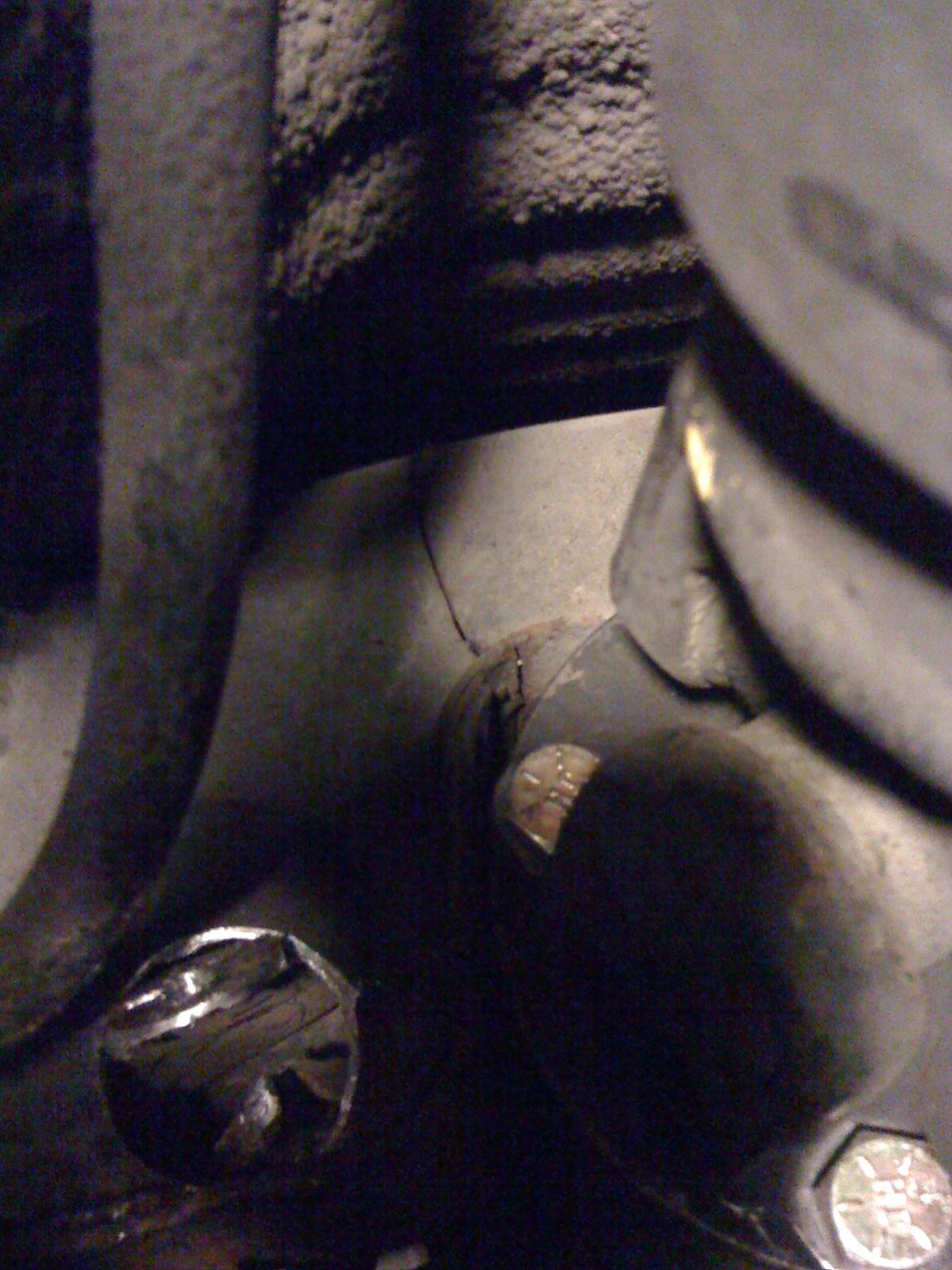

1 Attachment(s)
Last night i got under the car and realized that one of the main bolts to the Differential was missing. So i figured what the hell i might as well pull out the other one take it to a parts store and find something similar Right!!! Wrong half way through backing the bolt out it broke the nut end off from inside the Subframe. Now i have to cut it off with a sawsall and begin surgery
OOOOHHHH SS######T
Attachment 2790
What now any Suggestions?
I thought about cutting an access hole in the subframe with a grinder or torch then weld in a new one but it is kind of an uneven surface and it would be hard to get a welder to fit under the car and in a blind hole to weld a bolt perfectly in place, unless i dropped the hole subframe? SOuds like alot of work
Take Diff out Drill out old hole with larger hole saw - weld bolt to piece of subframe then weld back in the piece i cut out ? I thought this would be the easyest
any other ideas, I didnt see any access holes on the frame so it looks like i am going to have to make my own.

cre 02-19-2010 06:26 PM
I'd consider just cutting an opening large enough to fit the head of a spanner and not welding the nut in place.... I can't recall how well fortified that area is though; Some minor reinforcement may be needed if you want to keep the access port open.

Cre on in my hunting for the answer i have seen a few Broken Subframes in these exact spots. Now i am sure those guys had tons of power i an looking to be between 375 what i have now and 500 so i am not sure if i should or shouldnt weld something in. Right now i am considering Welding a Nut to a Rectangular piece of metel and sliding that in to the opening i create. I think this would help hold it in position, Make it so i only have exterior welding to do and be effective in securing it for future removal when and if it is needed. I think i will do a write up on it so everyone can see what i did if they encounter this situation
cre 02-19-2010 06:41 PM
The stock nut isn't welded in; it sits inside a metal box which is welded in. I suppose there may have been some revision or early version where the nut wasn't free, but none of those I've worked on have been welded directly in. Putting the nut free in a piece of U channel and tacking that down, similar to the stock arrangement, might not be too difficult.
A break in the place you're talking about isn't a power thing... it's a torque and excess play thing. Your diff's been pounding on it like a slide hammer... this could have happened in a Honda. Time to start going over the car and torquing all the critical fasteners... start with the subframe fasteners next.

cre 02-20-2010 04:28 AM
Welding the nut to a floating piece of U channel is not a good idea. If the clamping surface is uneven you increase the likeliness of the nut placing an uneven load on the fastener with the U channel acting as a lever; I'm certain this is the reason for the original method of construction.
I would go at it from the side myself. It depends on how large of an aperture you need and what you're using to cut with and weld with though.
