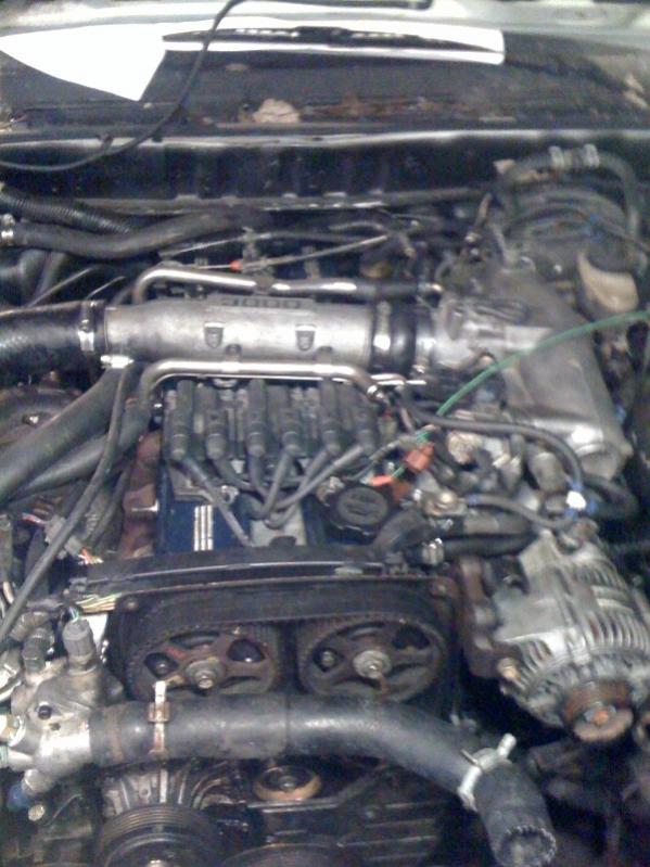

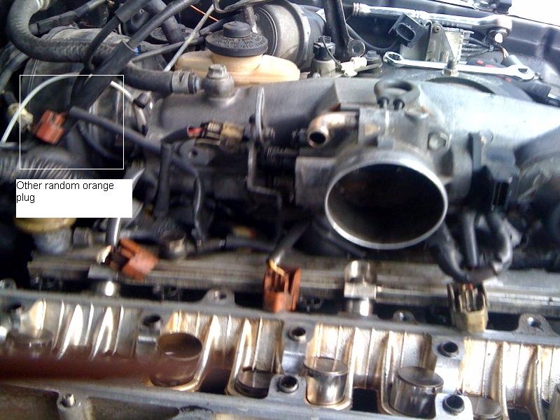

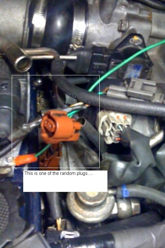

Well, everything is back together from my rebuild. I did a poor job of taking pictures in the beginning. I have a ground wire left over, and I'm not sure where it goes. My coil pack is grounded. I also have 2 orange female plugs between the injector rail and the intake. I can't figure out where they go. There were a lot of loose plugs in my car when I stated. Assuming some are because the car is 90 N/A, and the motor is 89 turbo...I took my chances and tried to start it.
The car is in time, and just turns over. It doesn't fire, but occasionally puffs a little bit out of the exhaust. I'm not sure if this makes a difference or not, but the tack jumps a little the entire time while cranking. It doesn't backfire, but it makes popping noises while cranking.
I guess I'm going to start with the grounding issues, and finding out where these orange plugs go. I'll post some pics.

There are two VSV under the intake plenum on the GTE, one is for the EGR and the other is for the fuel pressure regulator. Those plugs appear to be the VSV plugs.

Would these 2 plugs keep it from starting?
cre 11-18-2009 03:09 AM
No, not if those are the plugs I think they are... even if they aren't I can't think of any components that use that type of plug that would prevent the car from starting.
