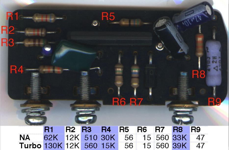

ok so you said something about changing out the transistors in a ge tach to make it work like a gte. so i canged the cluster again cuz i wanted a volt meter in the cluster instead of a boost gauge (just got a set of delphi gauges :)) and the tach doesnt really work so can you run me through how to make it work?

1 Attachment(s)
Just changing resistors... How about a pic?
Attachment 2808
supraluver4life 02-25-2010 09:02 PM
thank you. when i rev the engine the gauge doesnt really move. but when i turn on the lighhter plug and heater while rolling ddown the windows, the gauge works, is this because of the resistors?
cre 02-25-2010 11:19 PM
I've never experimented with swapping gauges just to see what happens when the wrong one is used, I do know that people generally report very odd behavior on top of the fact that it is a mile off when it does move.
supraluver4life 02-25-2010 11:37 PM
so i just swaped out the gauge circuitry from the gte tach to the ge tach so its a ge tach with the gte circuitry and wouldnt you know it...
it works :)
thank you for the help. i would have never knon that the resistors and such are different. thank you for the help in solving the problem :)
