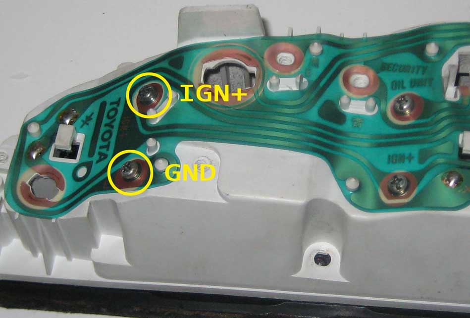

Does anyone have a picture of the back of an N/A gauge cluster? I'm a little confused as to what I hook up to it. I figured there would just be some leads somewhere not hooked up, and I'd just have to hook them up.
If anyone has done this, or knows what to do, please help!
tak2099 10-27-2009 12:16 AM
I already took out the boost gauge and the three wired box, and installed the volt gauge. I'm not sure if I need to hook it up, or if it will work off of the circuit sheet. please help! anyone!

cre 10-28-2009 03:04 AM
1 Attachment(s)
Originally Posted by tak2099 (Post 74368)
you have an n/a gauge cluster laying around?
Yes, as a matter of fact, I do. How odd is that? I'm not entirely sure why I haven't tossed it yet.
Here's a picture with the contacts for the voltmeter circled:
Attachment 2522
I can't remember if any of the traces are incomplete or missing from the GTE's circuit, if so you can use wires to connect the gauge.
