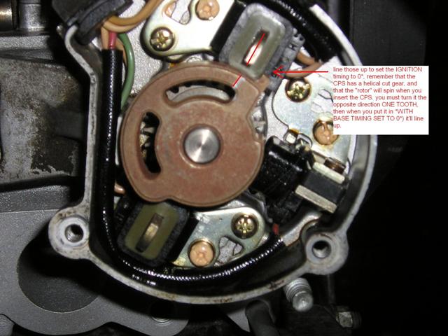

hey arent wire 1 and 6 the same anyway? does it matter which one i hook up?
also.. i did that.. lined up both cam to tdc and the crank at 0*
then made the cps look like this
Attachment 2168
(photo curtousy of saeff from sm)

I never aligned the cps with the cover off, used the marks on the shaft everytime I did it. Looks like that should be the correct position though.

so what marks do you use? maybe this would be better?
btwilson86 07-23-2009 02:48 AM
Yeah, the little rivet looking pin on the gear is supposed to be in line with the notch in the teeth right next to it. Check this out: TSRM
Kevin 07-23-2009 02:52 AM
ok i'm looking at my cps right now and there's 2 rivets lol which one???
