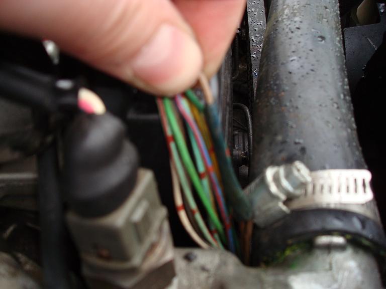

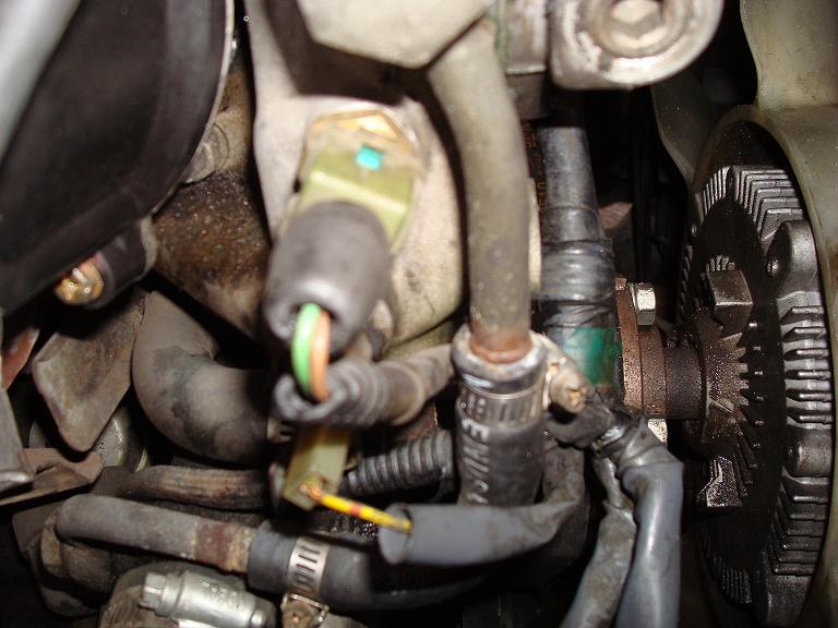

So I took a look at the wiring, and this is what I found.
The camera wouldn't really focus properly, but the yellow wire is bare at the beginning of the connector in this pic :
Attachment 2234
In this one, it shows two brown wires spliced into one. I'm wondering if this might be the issue:
Attachment 2235
Let me know what you guys think. I may be able to pull off the harness from my other car to fix it. Also, the maf was bad on this car so I have one from the US now that I got off of ebay. Both run fine on my parts car.
*Deadman* 08-17-2009 03:18 AM
Yea that looks a little dodgy man if you really want to you could change the looms or take it down to an auto sparky and get them to have a look
btwilson86 08-17-2009 06:00 AM
Yeah, I would check the wiring on your parts car's MAF sensor plug. Wire colors will probably be the same, and if so I would cut the connector off of it and splice it onto the Supra you're trying to get running. I'm pretty sure those 2 wires shouldn't be spliced together, but I can't say for sure as I don't have a N/A that I can easily go check the wiring on...
Hopefully that's your problem though. Would like to see this thread end with "I got the car running" sometime soon...
