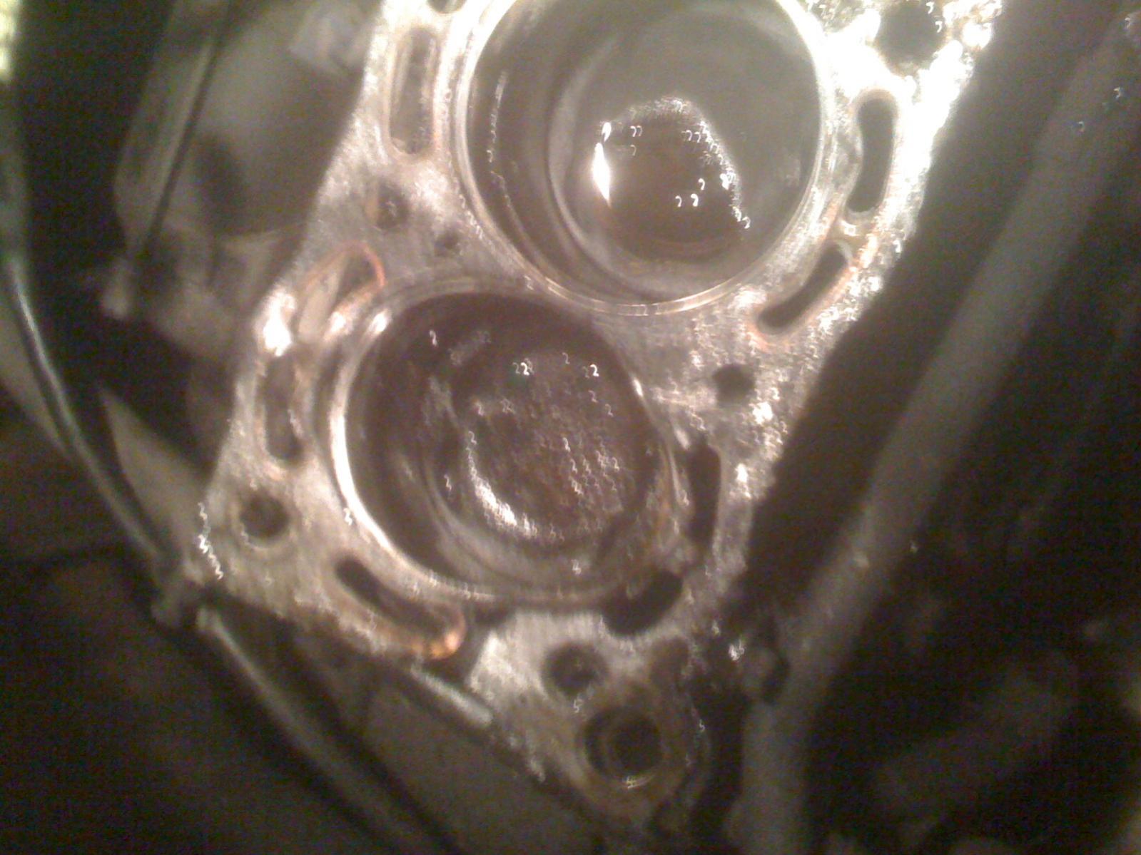

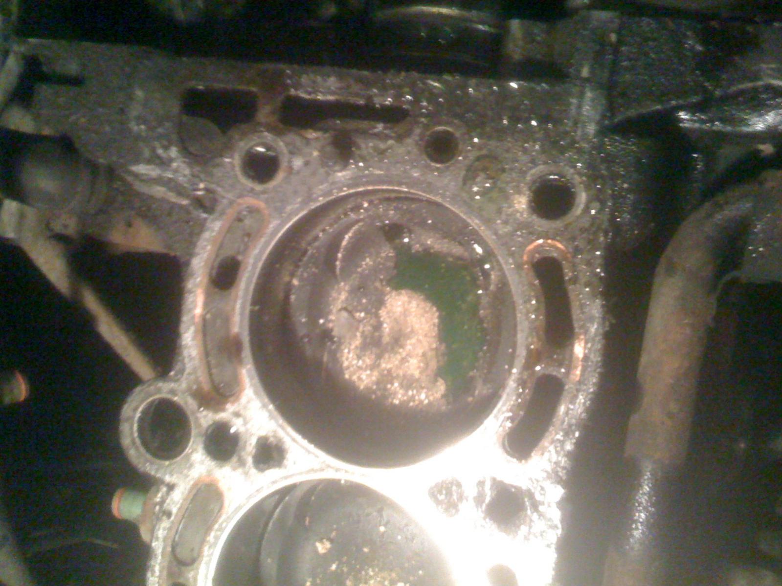

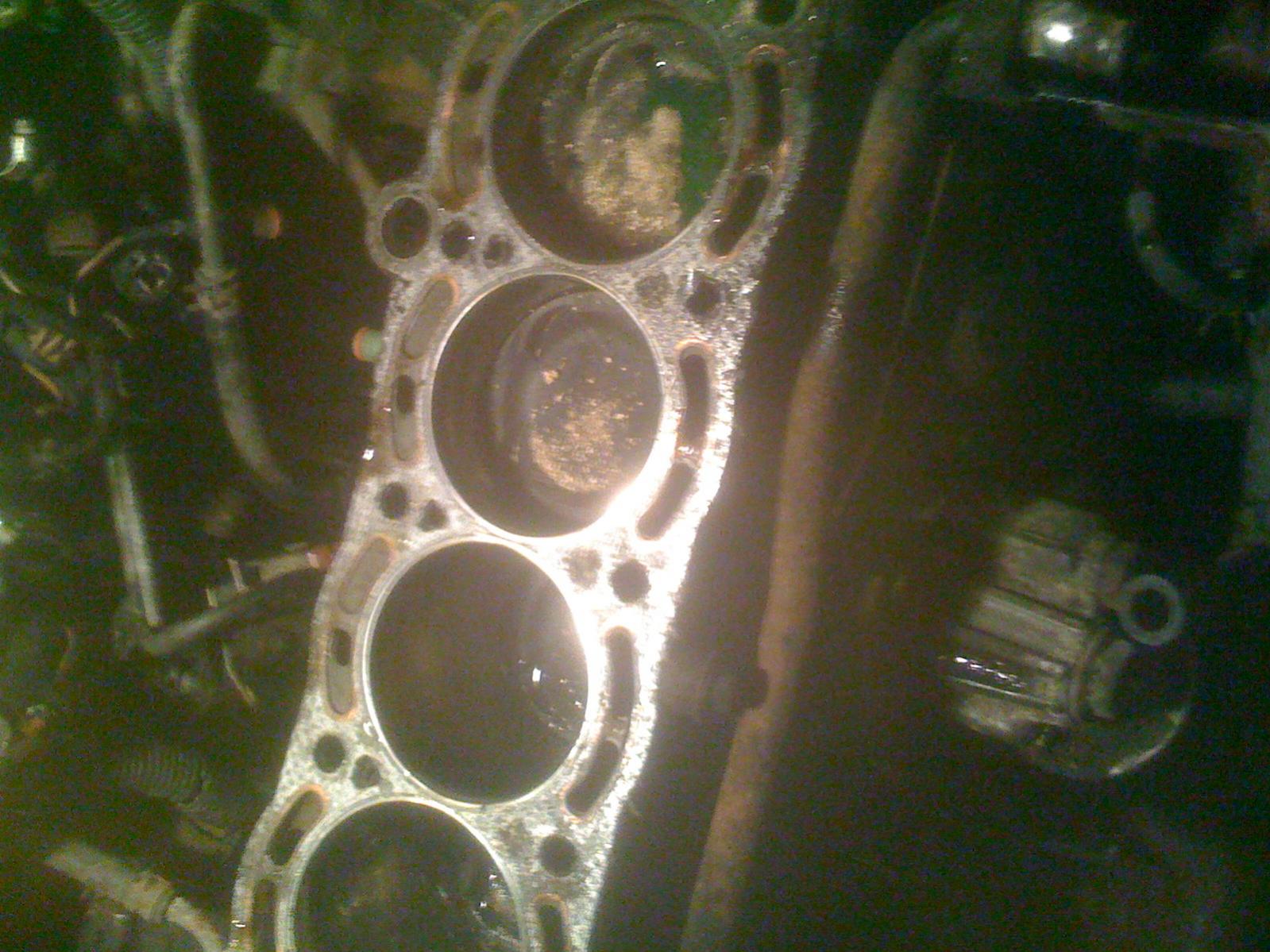

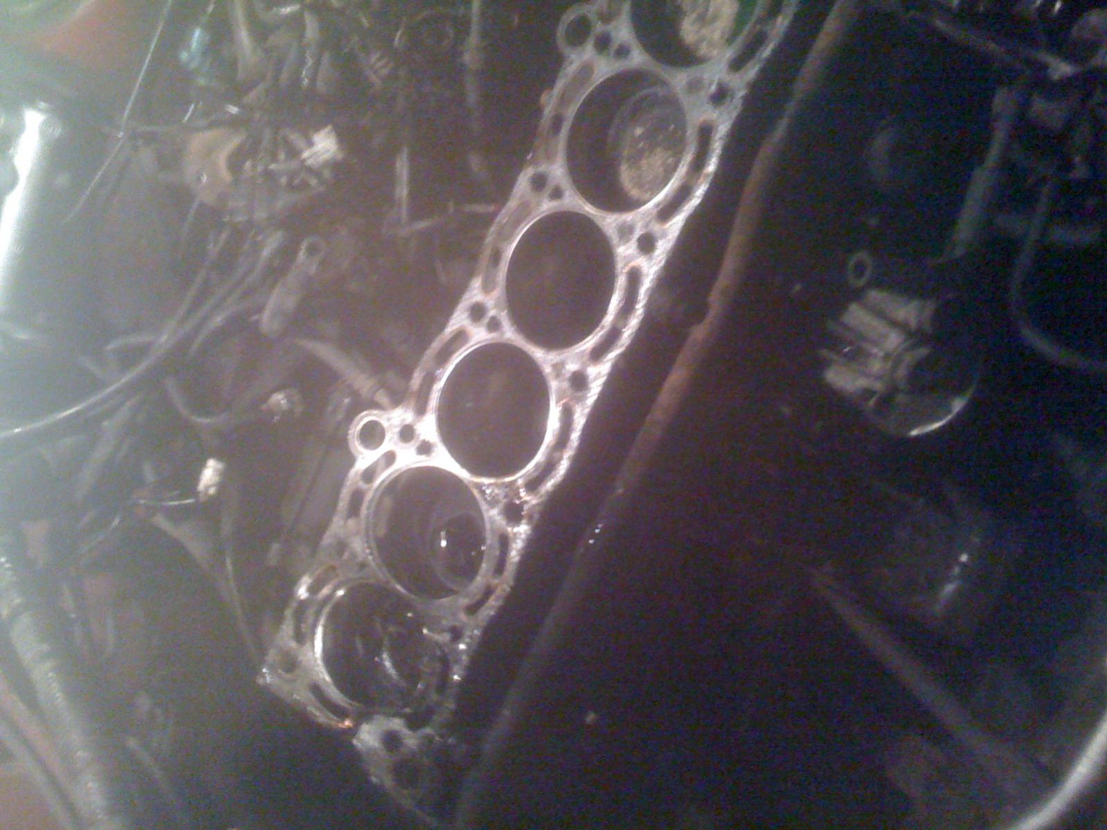

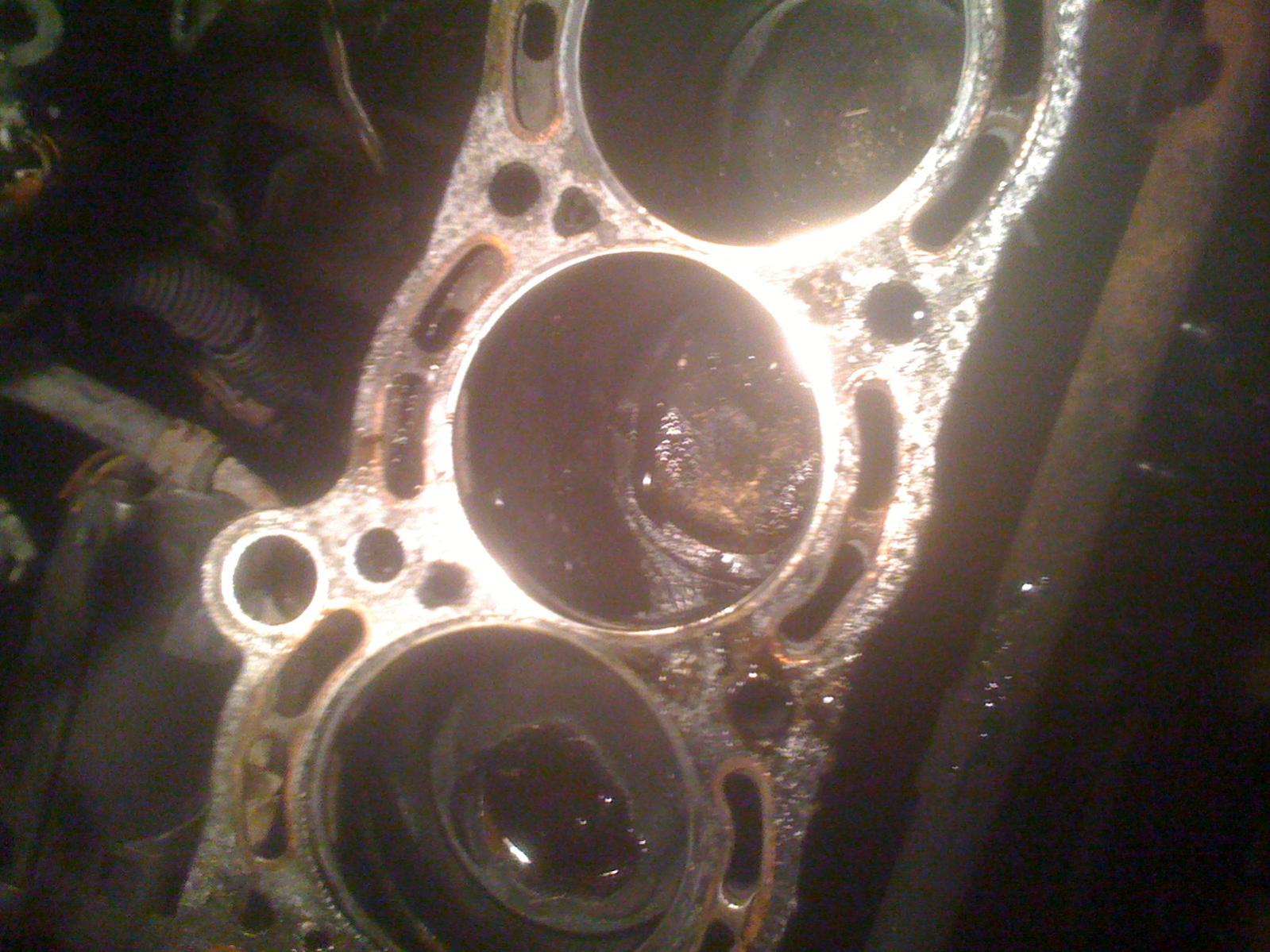

So i finally have the head off ater running into a million problems.. stripped bolts..impossible turbo (i ended up cutting the downpipe to get it out.. and even out.. i still cant seperate the elbow from the turbo..).. then went to take the head bolts off.. got to bolt #5.. and rounded the shit out of it lol.. so tried some extractor bits.. involved a little drilling (super scary).. that didnt work.. bought a new set of torx bits.. got the next size up and jammed that shit in.. and finally it crackked free... eveything was smooth there.. got the head off.. and holy shit the hg was in the shittiest shape ive ever seen..
Attachment 2034
Attachment 2035
Attachment 2036
Attachment 2037
Attachment 2038
Btw sorry for the shitty pics.. i took them from my phone.
