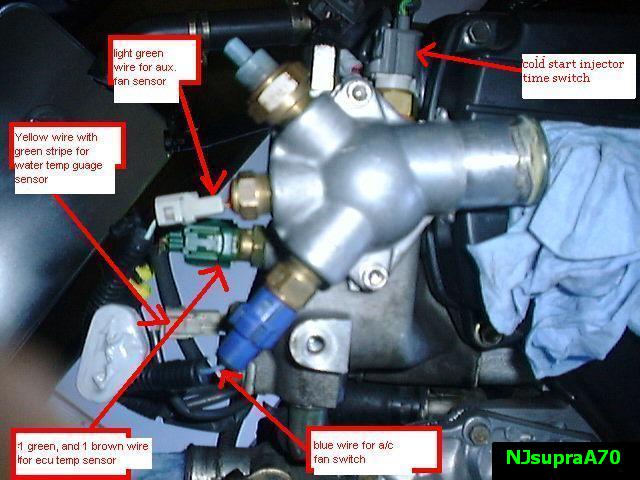

Another of the thermostat housing. This one shows the Cold Start Time Switch.
Attachment 4497
