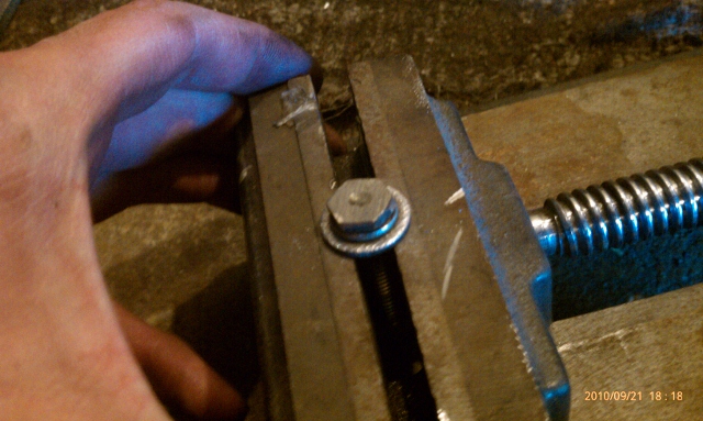

If you plan on runnin your AC Which i did cuz it gets hot down here! And nothing better then kicking someones ass while you AC is blowin on you in 105 weather. Your gonna have to pull this stud out that holds your ac compressor and replace it with a bolt cuz it hit the Top plate you have to take off the 7mgte ac compressor. You also have to notch out the powersteering bracket due to the bolt that holds the ac hoses on hit it! DO THIS BEFORE ENGINE IS IN CAR!
The stud that needs removed.
Attachment 3749
