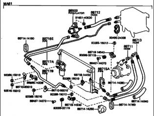

just did this so ill share some info
Attachment 2974
so bassically start by releasing any pressure in system:
Attachment 2973
remove plastic screw-on caps and push it like a tire valve stem
then basically unbolt the unit from the block

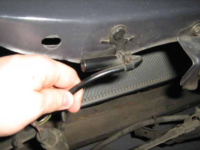

every thiing else is obvious except the ambiant temp sensor mounted on the cooler fan infront of the rad
mount it here and keep it plugged in or lose the use of your heater!!!!
Attachment 2972
