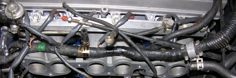

Next I installed the fuel rail and injectors. Soaked the injectors for several days in CARB Cleaner and cleaned off all of the connectors with Brake Cleaner.

Used all new O rings and grommets from the rebuild kit. The 90 Supra does not have a pulse damper on the fuel supply line. I spent an hour looking for one in the parts bag.
