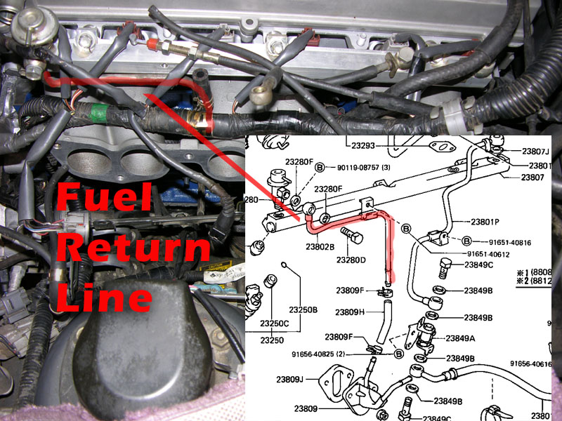

Spent a week working on the drivers side wires and hoses. It was mess to figure out so I have documented my findings so they be of assistance in the future.

The key problem is that several lines have to be run though the intake runners before the manifold is installed. Also, there are several things to connect before the manifold is placed.

Before installing the Intake runner, you will need to route several lines through the runners BEFORE placing the intake on the head. Run the supply and return fuel lines, IAC Hose from the manifold, and water bypass hose through the runner.
ID:	2362 Click image for larger version
