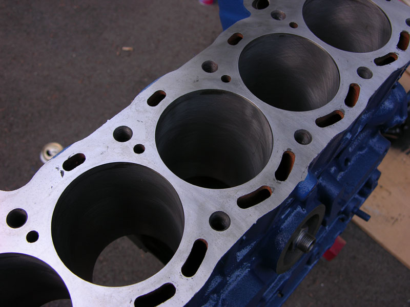

After a week in the machine shop – finally got my block back.

Tests showed no cracks so that’s good. The head gasket had been leaking water for some time so there was a lot of pitting around the water ports. The shop had to plane the block surface to remove most of the defects and prepare for the new gasket.
