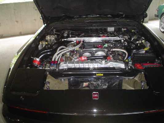

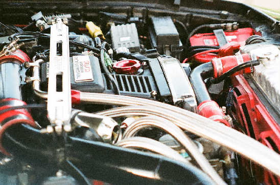

i agree, before any mods install a MHG. don't listen to that one reply you received "don't worry about your gasket". the 7M is an awesome engine except for the gasket. stock internals can handle 500hp, and it sounds like eventually you'll be looking for more power. i should know because the only internals on my car are AEM gears, and an HKS 1.2 MHG. don't worry about how much time you have to build your ride. you're very young, and have plenty of time. it took me 8 years to get my car the way i like-it. by replacing your gasket now, you're premptively saving yourself trouble down the road. by the way, don't forget about the ARP studs. one addition you can safely change is an air intake. checkout a list of my mods on tunerfriends.com username is "iluvmy88supra"
