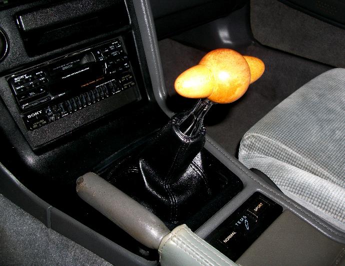

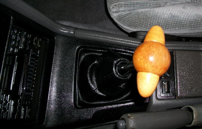

My gray OEM Toyota shift boot was showing it's age after 31 years so I decided to replace it with something from eBay. Leather shift boots are expensive so I went with a black vinyl smooth leather look boot for about $13 delivered. I studied the old boot before I took it off. Cleaned and rustproofed the iron frame. I used contact cement on the frame and on the back of the boot material where it was going to wrap around the frame. This boot is supposed to be a direct OEM fit and it ended up being that way. I have a C's short shifter so I pushed the collar down around the chrome neck for the look I was going for. For $13 and an hour of effort, I'd say its an improvement.

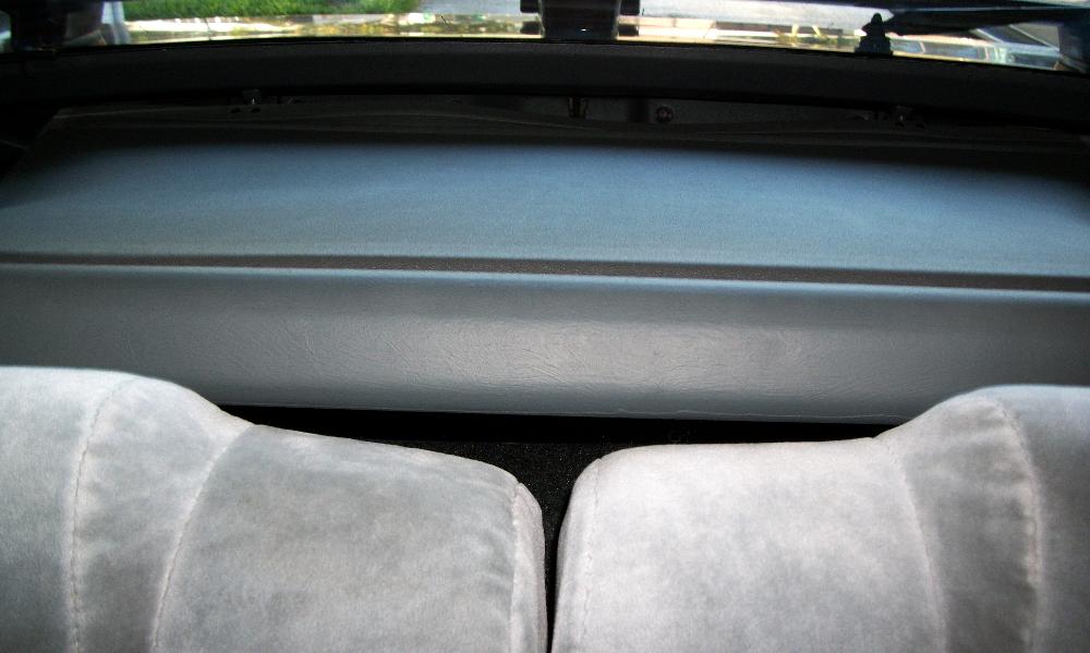

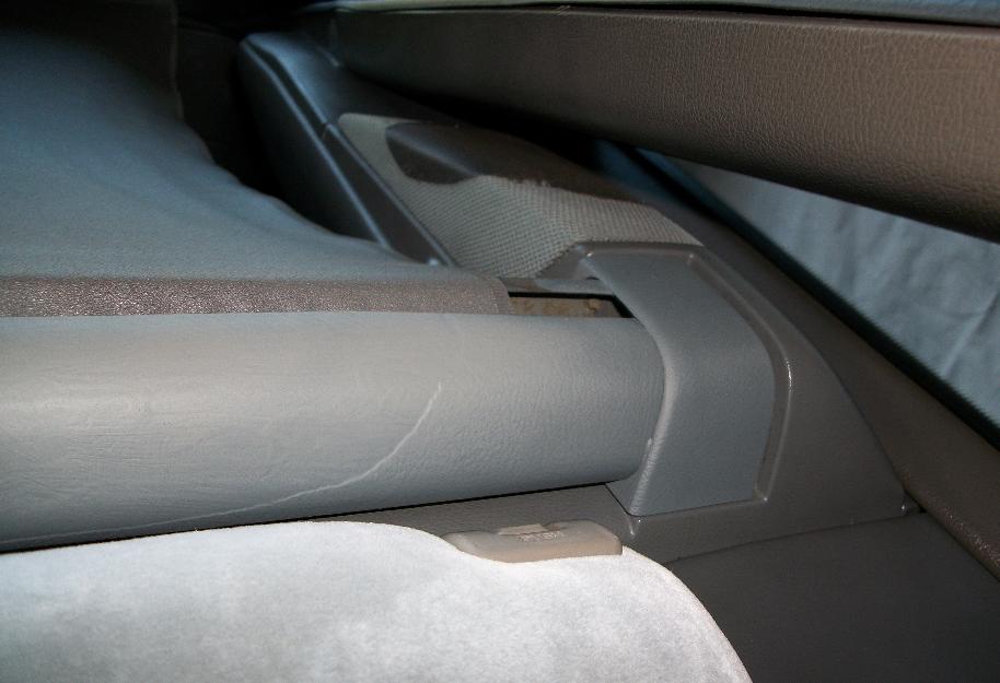

Another problem that old Supras have is that the trunk cover housing cover cooks black from the sun and the vinyl peels off the metal. What I used was Duplicolor charcoal gray vinyl and fabric spray. I cut off the burnt black gray vinyl and sanded the area to be coated with Rustoleum rust reformer liquid. I used a small brush and several coats to try to give it some texture. I pulled out the rollup cover slightly and inserted newspaper to protect the vinyl roll from getting painted. Several spray coats later, it looked better than before. A week later I put some Toyota vinyl treatment on it which darkened and shined it slightly. I don't have a photo of that though. Just the before photos.
Check out the photos of the new shifter boot and carpet and trunk cover housing repair.
