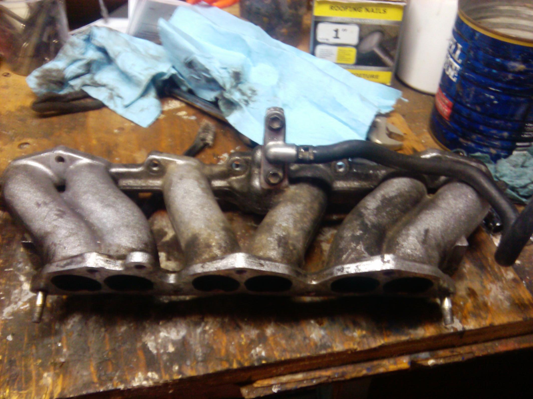

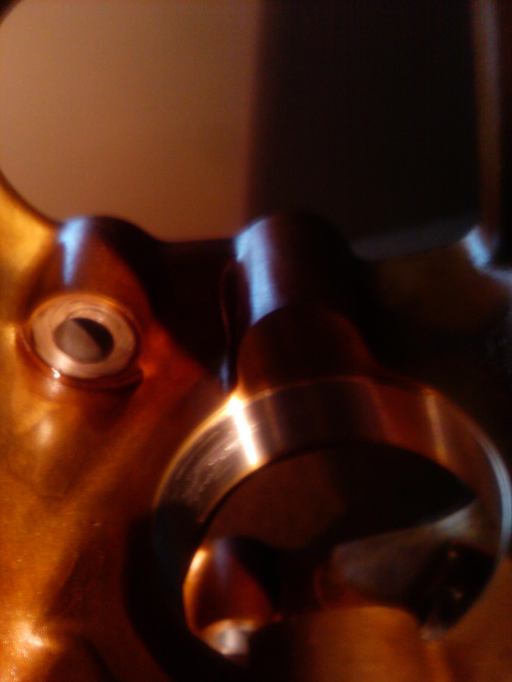

Just cleaned up parts and such today and measured my head studs, some had about 2mm stretch in them I just hope I can still use them. Also found out the whole felpro seal kit I bought is missing a lot of gaskets which is a huge let down. To add to that my cam towers need some serious machining looks like shavings got in between the cam and races in the towers, but the lobes for the rocker arms are perfect.

Worst one, felt litterly like sand paper, yet the cam wasn't to bad.
before
