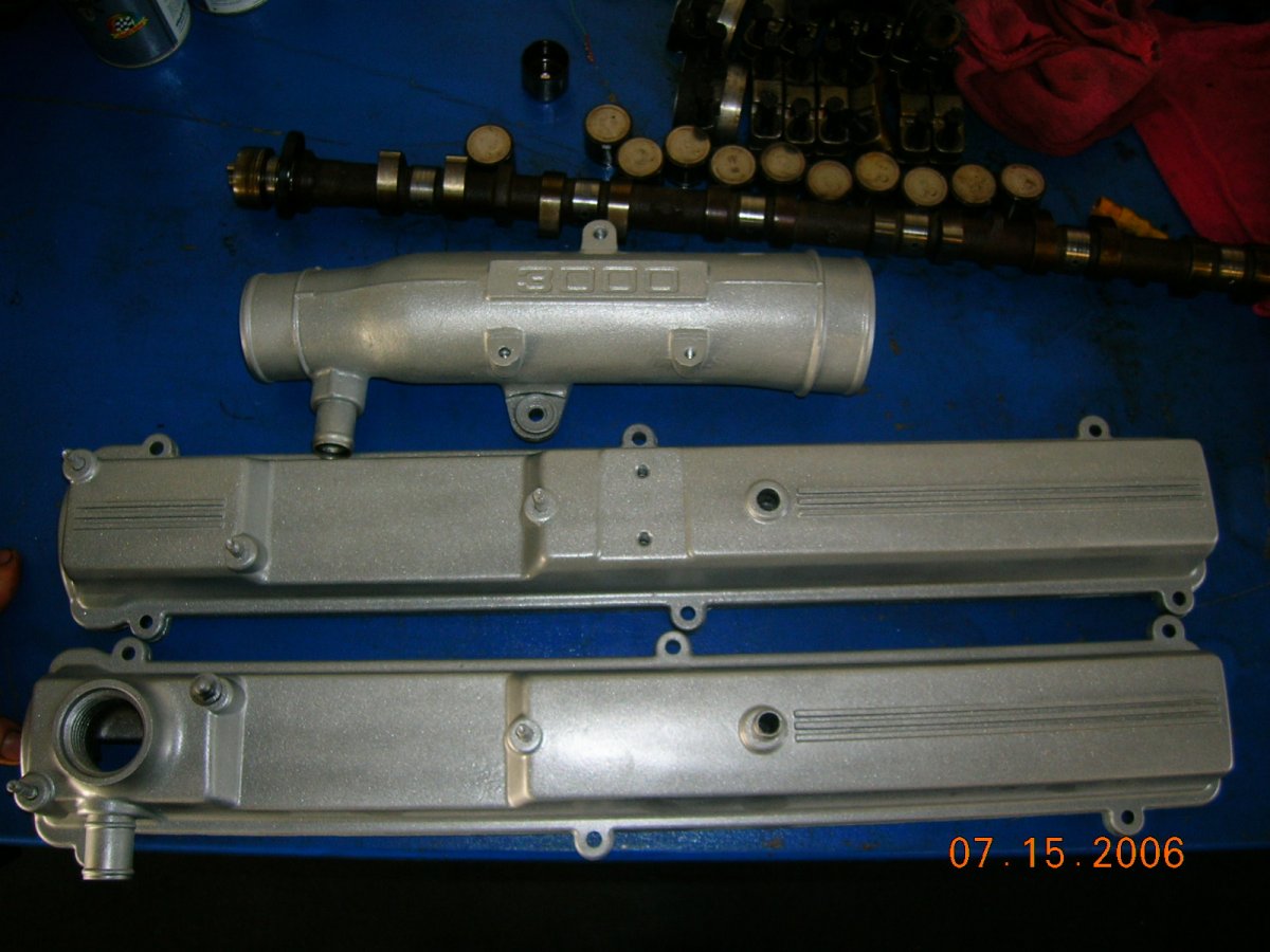

Name:	machinned head online.jpg

Name:	valve cover painted.jpg
ID:	472   Click image for larger version
Name:	valve cover painted 2.jpg

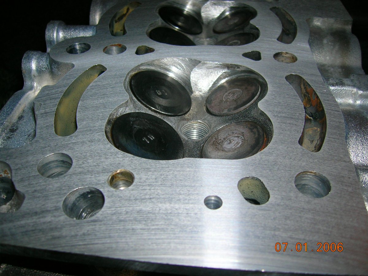

see the lines left by the milling machine ?
i removed those lines by hand, using a lapping tool

How much did you skim off your head ? looking at your photo there seems to have been a lot of material removed. This is the photo of my head straight from the block.

cant remember but it was a bit, that's why the machinist recomended me to get a 1.4 or a 1.5 mm head gasket also I ot in touch with a company that sell the cometic headgasket and told them how much it had been taken off of the head and he figured the same. It could of posibly been 20 thousands or something like that..
